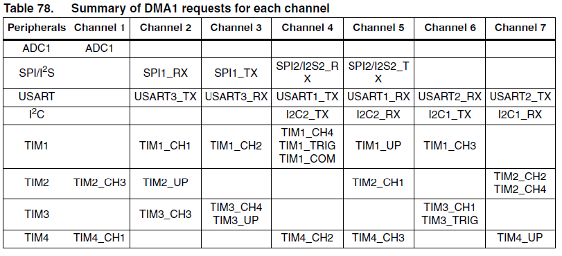

I have a problem that maybe someone can help with. I've spend the last few days on this and I just don't understand why it's not working.
I have a STM32 where I want to send out a buffer over USART 2 using DMA to a RS485 chip that sends it to a Hyperterminal via FTDI cable. I had this working using USART without DMA... by just feeding the Register with the buffer one by one. So I know that the USART and the RS485 chip works. After inital problems i have gone to a simple example from ST Library and modified it but still can't get it to work. Here is my code.. I'm trying to continuosly send out data over USART2. The problem: It doesn't send at all... or only once.. and usually gets stuck here: while (DMA_GetFlagStatus(DMA1_FLAG_TC7) == RESET) Can anyone see what I'm doing wrong?/* Includes ------------------------------------------------------------------*/

#dma #stm32-usart-interrupt-dma #dma-tc-interrupt-usart2012-08-30 8:48 AM
I think it's because you need to program DMA for each transfer.

2012-08-31 12:44 AM
Thank you kind sir! You are a hero! - It works now :)
I wasted so much time on this - and i still don't understand why it's necessary to reinitialize the dma before each transmit... but it works for now.2012-08-31 6:39 AM

2012-08-31 6:57 AM
DMA has two modes. You are using the ''normal'' mode, which is a one-shot transfer for a fixed length. DMA stops at the end of the transfer.

Something you'd expect to find in a Reference Manual?
From the STM32F1xx one
