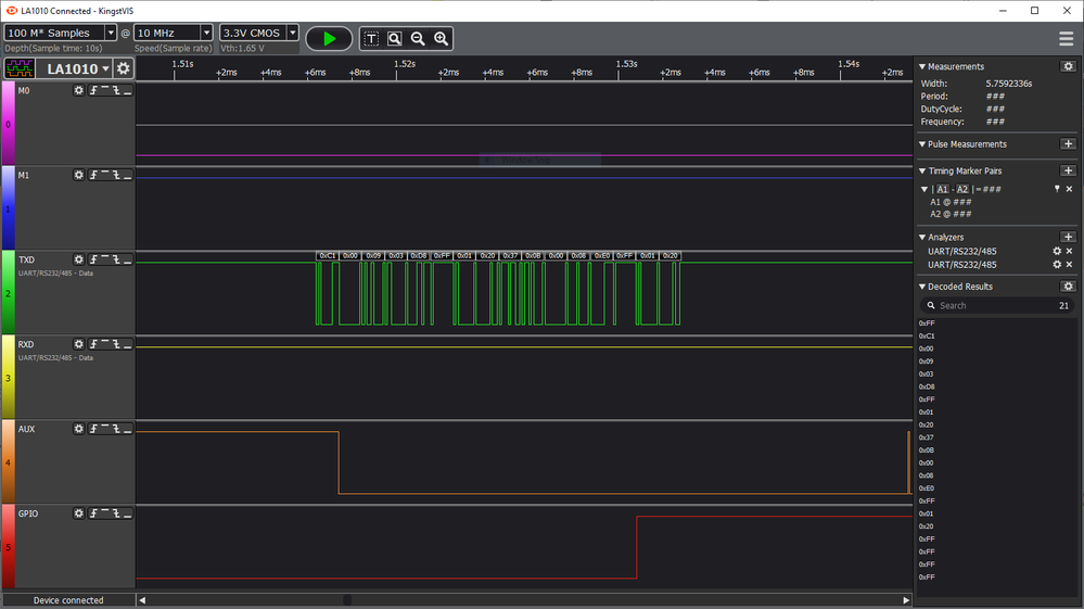

2019-08-08 10:47 AM
I had the same problem. It is not documented, but problem is because DMA TC interrupt flag triggers when the las 16 bits data have been transfered.
For example here I am passing 16 bytes from memory sram to uart, when TC is triggered I have toggle a pin, and it is clear that transfer is not totally complete in uart, but for dma is complete. Just the las two bytes are not complete transfered in UART peripheral.
