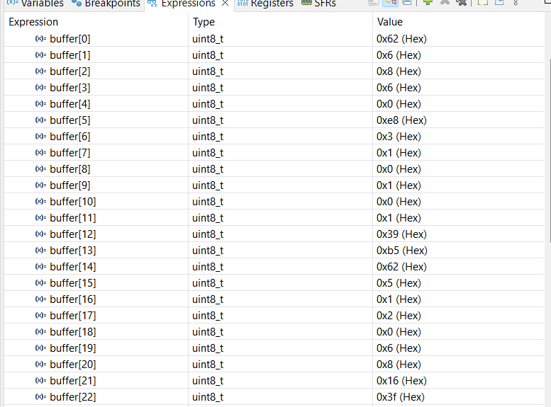

I am using UART to read data from the NEO-M9N GPS receiver. My receive buffer stores all received data besides the first byte:
This forum states to add a delay between initializing UART and sending data, and this forum states to clear the buffer before transmitting data. However, neither solution works for me. These forums are addressing an issue where the first byte received is 0x00. However, my issue is that rather than receive 0x00, I skip the first byte entirely.
Any tips on how to fix this would be appreciated. Thanks.

You set buffer_idx to 0 but the callback of last byte of the previous reception already called HAL_UART_Receive_IT() with a high value for buffer_idx. Only after the callback of the first rx byte, the HAL_UART_Receive_IT() will use a buffer_idx of 0.

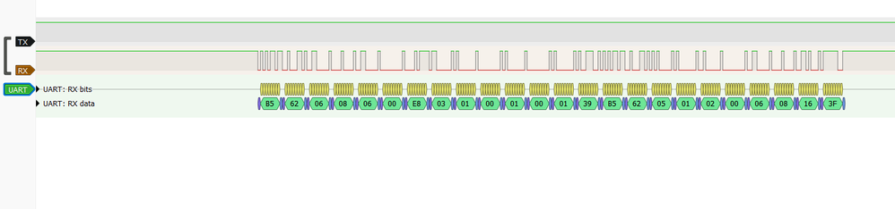

I placed a breakpoint inside my callback function, and when looking inside the RDR register i see 0x62 instead of 0xB5. The callback function is never called when the MCU receives 0xB5, so 0xB5 is never stored inside the buffer. Why does it skip over this first byte?

As already explained by others, the problem is your code.
It should have been clear by taking a closer look at the logic analyser image. The first byte - 0xB5 - is clearly present.
When debugging, the initial assumption should always be that one's own code is the issue.
