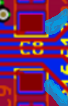

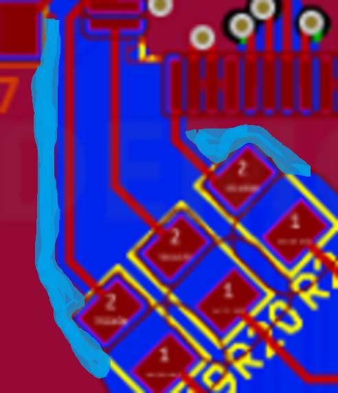

2020-08-18 9:45 AM
This will increase parasitic capacitance and reduce sensitivity.
Nevertheless, on MCU side, R15/18/19/21 gnd plan is too close from signals in 4th places.
See modification proposal in light-blue.
For R15/R18:
For R19/R21:
