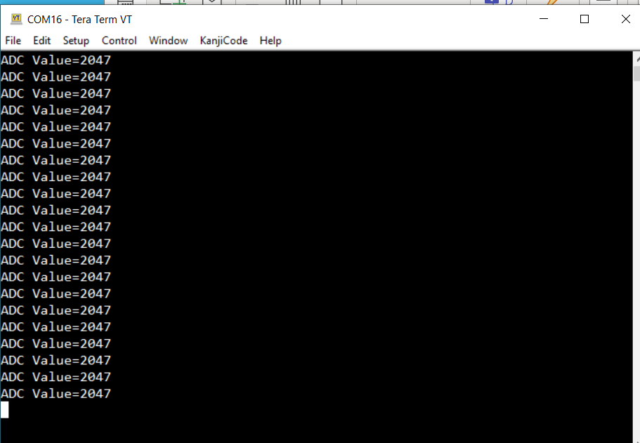

I made a typo error in line below (/r/n vs \r\n):
adc_len = sprintf(adc_buf, "ADC Value=%d/r/n", readValue);
Change it as follow:
adc_len = sprintf(adc_buf, "ADC Value=%d\r\n", readValue);
Otherwise this code works very well (see screenshot below)
Check your hardware connection.
Check your terminal settings baudrate, word length, parity and stop bit must be aligned between USART Initialization and your terminal.

Sorry.
