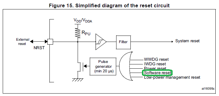

Assume it drives NRESET low, as would an external reset button. Which is why it's important not to drive NRESET high with external circuitry as it prevents the CPU from resetting properly.
2015-01-08 6:10 AM
From RM0090
''Software resetThe reset source can be identified by checking the reset flags in the RCC clock control & status register (RCC_CSR).
The SYSRESETREQ bit in Cortex®-M4 with FPU Application Interrupt and Reset Control Register must be set to force a software reset on the device. Refer to the Cortex®-M4 with FPU technical reference manual for more details.''
