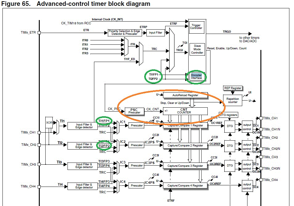

On what part exactly? ST makes dozens of STM32xxx parts. Some will require AF pin routing to be specified.
How does CH3/4 route to TI1FP1 or TI2FP2, refer to ''timer block diagram''2012-08-22 10:24 AM

Ok maybe that's the issue. I am using STM32F407VGT6 part and it looks like PC8 and PC9s alternative function is TIMer channels 3 and 4 so it won't connect to channels 1 and 2 that are needed for the encoder interface. I wish I had looked at that diagram more closely when laying out my board. I am assuming I can't use the AF function to connect to another channel if it is not available in the AF list for that pin. (I don't have a complete grasp on the AF feature yet.) Is it true that one needs to define AF functions for any pin that is being used other than as a simple GPIO? For example if using SPI I need to set up port using AF assignments?
2012-08-22 11:58 AM
For non-GPIO function the pin drivers need to be connected to the appropriate peripheral using the AF pin multiplexor.
This isn't a cross-bar switch, so the specific pins, function and peripheral selection is limited. Refer to the ''Alternate Function Mapping'' table in the part datasheet. Pg 58http://www.st.com/internet/mcu/product/252jsp
http://www.st.com/internet/com/TECHNICAL_RESOURCES/TECHNICAL_LITERATURE/DATASHEET/DM00037pdf

Thanks for the tip Clive. I had mistakenly assumed that peripherals could be remapped. Always something new to learn. BTW where did you find that diagram for timers you posted? I can't see it in the RM0090 reference.
Thanks2012-08-23 12:03 PM
Ok never mind I found it.
Thanks2012-08-23 12:48 PM
I pulled it out of RM0033, for the STM32F2 as most STM32Fx parts share a similar construction, and I had it open already.
