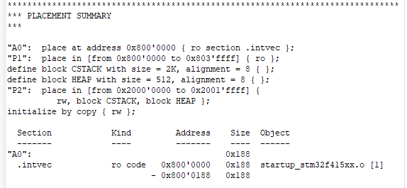

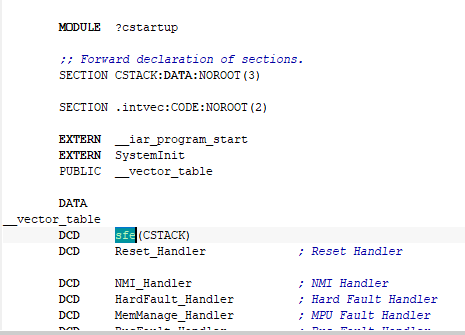

Thank you for your answer. I couldn't find how to set the address of the stack pointer. The contents of my startup file are as follows:
The starting address is defined as 0x08000000 in the .map file.
VEC_TAB_OFFSET value is defined as 0x00000000 in the system file.
I don't know where I made a mistake. I will be glad if you help.
