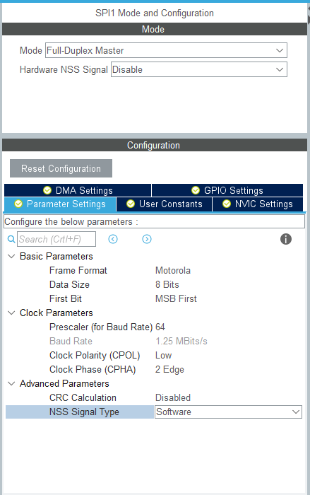

I'm using a Nucleo L476RG as a master and I want to use it in SPI mode 1, which means the data is transferred in rising edge of the SCLK and data is sampled in falling edge (based on ST documents). Is this the correct configuration for the SPI mode 1? and if not, then how should I set it?

Try yourself, look with a scope on the data lines, compare to datasheet and reference manual and draw your conclusions. If you can only answer "somebody told me to do so", that is not good in the case of failure.
