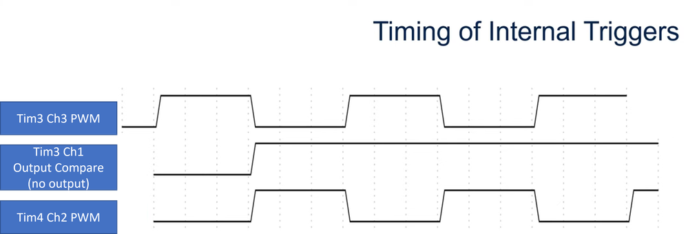

General objective: Generate 2 PWM's on Timer 3 and Timer 4 respectively at 50% duty cycle, both with period of 2 seconds and phase shift of 1second between them (Timer4 will start 1 sec later).
Because I want it to be precise, I am not considering using a simple HAL_Delay(1000) between the 2 HAL_TIM_PWM_Start(). In fact, I would like to internally trigger/enable Timer4, using Timer3's Output compare match (active level on match).
The motivation of what I'm trying to do came from this STM32 video showing the internal triggering system, where I tried to replicate as far as possible, albeit just using the 2 LEDS from Tim3(Ch 3) and Tim4(Ch 2).

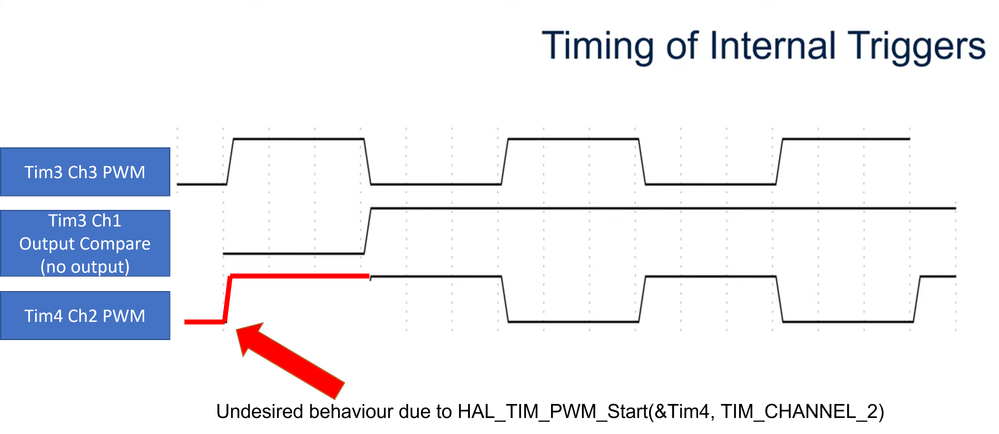

I already have success creating this delay between the 2 PWMs. My issue is that for the very first cycle of the PWMs, both PWMs (well LED in this case) are lit up at the same time.
Thereafter (after the first cycle), when PWM (Tim3) is on, PWM(Tim4) will be off, and they will lit up alternately in the correct fashion.
Timer3 Channel3: PWM output (period 20000 [2 secs], pulse 10000 [1 sec])
Timer3 Channel1: Output compare (no output) pulse 10000 to get 1 sec delay, Active Leve
Timer4 Slaved Mode: (Tried both Gated and Trigger mode, my examples below shows Gated mode)
Timer4 Channel2: PWM output (period 20000 [2 secs], pulse 10000 [1 sec])
Using Timer 3, channel 3, I have no issues starting a PWM using HAL_TIM_PWM_START().
Immediately right after, I start my Timer 3, Channel 1 (Output compare, no output) so that once it reaches it's appropriate count, it will trigger (Active Level on Match) for Timer 4 to start (1 second delay as compared to Timer 3).

But if I were to not run this line, the LEDs/PWM for Timer4 Channel 2 will never ever be lit up.
2021-10-17 5:28 AM
As part of my debugging process, I have verified that the Timer4 is indeed correctly lagging behind Timer3 by 10000 counts (continuously verified using HAL_TIM_GetCounter()), proving that the Timer4 delay is ok.
The issue is purely that Timer 4 PWM turns on once the CCxE Bit is set (using HAL_TIM_PWM_Start). Why is it on? The reference manual suggests that this is because the Timer4 counter (although not running/started, has a value of 0), which since it is lesser than the Tim4, Channel 2 CCR value of 10000, indicates that it should be Active (I did not switch channel polarity, nor use PWM Mode 2). Therefore the PWM turns on immediately, even Timer4 has not been triggered to start yet.
2021-10-17 5:53 AM
Possible solutions, albeit seems very unclean.
Option 1) After PWM_Start and OC_Start for Timer 3, use a HAL_Delay(1000) before running the PWM_start for TIM4, Chan2. By toggling the CCxE bit 1 second later, the first inappropriate LED activation will be manually delayed. The timers will still be accurately spaced exactly 10000 counts apart. Looks untidy, but seems to work in the long run because the timers will be accurately spaced 10000 counts apart. Down side is that for the very first blink, there is no guarantee that the TIM4 PWM will be activated exactly on time since we are just using software delay.
Option 2) Modify Tim4->CNT value to 19999 before running PWM_start for TIM4. In this manner, even though the CCxE bit for PWM is set, because the CNT value is higher than the CCR, the PWM will be InActive for that undesired first part. For subsequent cycles, behaviour will be just as desired. Down side is that the timers are not exactly 10000 counts apart, but rather 9999 counts apart forever, since my Timer4 was only 1 count from overflowing at the start. Considering the timespan of mankind on earth, that 1 count is nothing, but it's just very irritating to have a defect of 1 count when I desire 10000 counts apart.
Option 3) Initialise Timer4 Channel 2 PWM CCR as 0 (rather than 10000), to ensure that the LED/PWM does not lit for the first time. Since CCR (0 value) would equals the starting value of Tim4 CNT (also 0), the PWM will be inactive. Right after running PWM_start for TIM4, change the TIM4->CCR to the correct 10000. Here comes the catch, if Preload is enabled, the Tim4 PWM will only light up AFTER completing this cycle. (meaning TIM4 will not switch on right after TIM3 PWM switches off).
If Preload is disabled, then TIM4 PWM will immediately go to Active, even if our TIM4 timer has not been triggered to start yet.
Option 4) At this point, I'm really out of ideas and would really be keen to see what it is I am doing wrongly and how it is u guys are doing it properly. What puzzles me is that the youtube video link above shows it working perfectly while mine has this initial defect. Please help...
