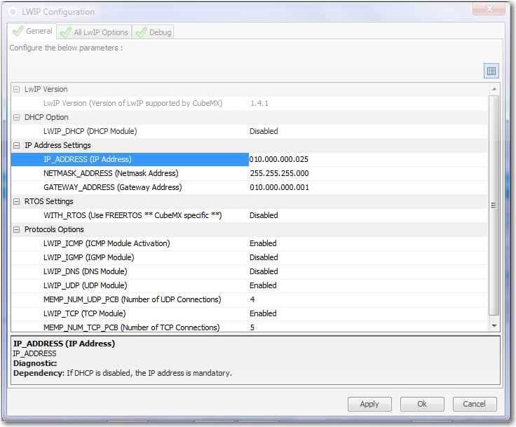

2015-07-15 5:06 AM
Yes. Use STM32Cube MX LwIP configuration window to specify the IP address (Disable DHCP to see the IP address field) and see the specified IP address in the generated file called ''lwip.c''.

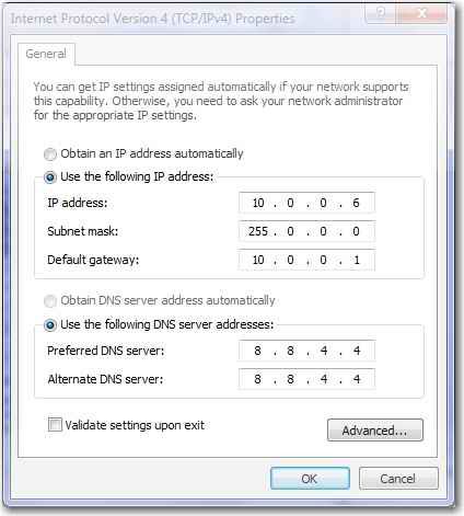

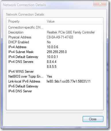

You need to make sure your computer and your board are on the same network (same address range) or you will need a routing table to route packets from one to the other. You have configured your board IP address to be 10.0.0.5. Configure your PC address to be 10.0.0.6 for example, and reuse the same gateway IP address 10.0.0.1.2015-07-17 4:27 PM
So I must set my LAN network as static IP with 10.0.0.6 ? thanks
2015-07-17 4:58 PM
I have set it, but still can not ping to my STM32 board....I'm using RMII setting for ethernet...and DP83848 chip for PHY....do I need a clock from STM32 or can I use a clock from the module itself ? it has a crystal but there's a port for OSCIN..??

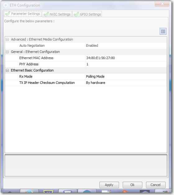

Here're the setting on STM32CubeMX for MAC and IP address, I think there's something wrong with it...?? I follow all the procedure and hardware connection carefully and still can't get, at least MAC address...
It works already, but I'm not using STM32CubeMX generated code, I'm not sure, the code generated from STM32CubeMX is reliable for STM32F..
