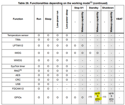

Hello @KMill,
According to RM0444, there are up to 5 pins wakeup from Standby/Shutdown mode capability:

Unless I am missing something "Up to" is the key there ;)
Unfortunately as far as I can see the G031F6 has only 4. :(
