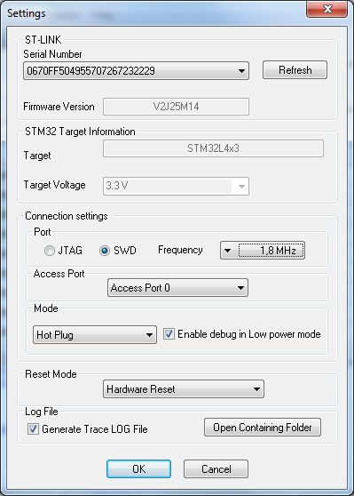

SWD frequency is set to 5kHz, which is veeery slow.
Try increasing it to something like 1.8MHz in 'Target/Settings' :
