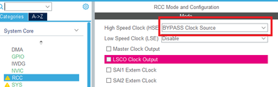

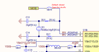

The crystal is not soldered by default on the board but you can use STLINK-MCO output as a clock source for your case: and you need to be sure the solder bridge SB50 is closed.
For that you need to configure the RCC/HSE in Bypass mode:
and be sure that the input frequency is set to 8MHz.
Hope that helps.

2025-02-01 11:51 AM
Hope that helps.

It ended up working!!! Thank you so much. It is worth noting that SB16 also had to be closed
