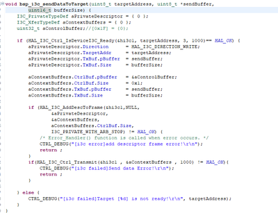

I used STM32H563 transmit a message through I3C CCC direct.
I create a new CCC command "0xA0".Control send the command to target.But target will enter
HAL_I3C_ER_IRQHandler
Uesd the general command "0x89".The target can receive this command. The Buffer is same.

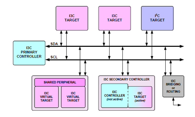

And i have another question: can the target of I3C send data to the master of I2C?My system doesn't necessarily have an I3C controller.
2024-02-28 12:08 AM
The I3C bus only supports I2C targets.
You can configure the I3C bus :

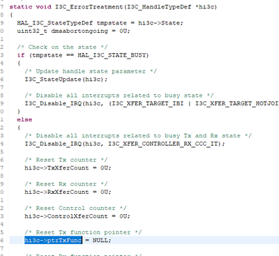

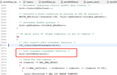

When the controller sends data to the target, if the sending fails, the system will enter a hardfault.
The reason is that the hi3c->ptrTxFunc pointer will be cleared in the I3C_ErrorTreatment function, but the hi3c->ptrTxFunc null pointer will be called in the retransmission function, resulting in an error, which is unreasonable.

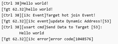

My target got dynamic Address . My controller send "HAL_I3C_Ctrl_IsDeviceI3C_Ready",the target will enter frame error.Error code is 0x100000.
I dont understand.
2024-03-07 8:59 PM
I know the cause,ST's library only supports fixed-length receptions. If Tx size is not amount Rx size , it will generate
HAL_I3C_ERROR_SIZE error code.
