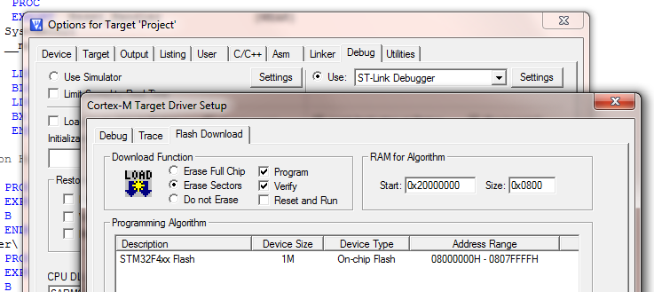

then? Not sure what version of Keil supports the F401 chip, and if you have to install some other package/patch to Keil to address. In 4.71 you can just set the Target to a F405OE, truncate the memory settings to those of the F401, and select the regular 1MB flash algorithm. Make sure it has the right defines, and uses the appropriate startup/system files, and you should be fine.2014-01-17 1:40 PM
The error you get specifically means it doesn't like the Device/Target selected for the project, or the Flash Algorithm picked to program it.

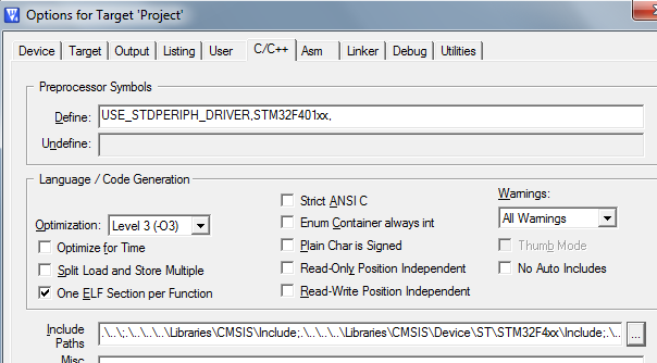

Yes, I do have the STM32F401C-DISCO.I went and set the target device to STM32F401VC which is what I believe is what is on the discovery board. Now I get a bunch of compiler errors every time stm32f4xx.h is included which is a lot. All the errors areexpected a ''}''

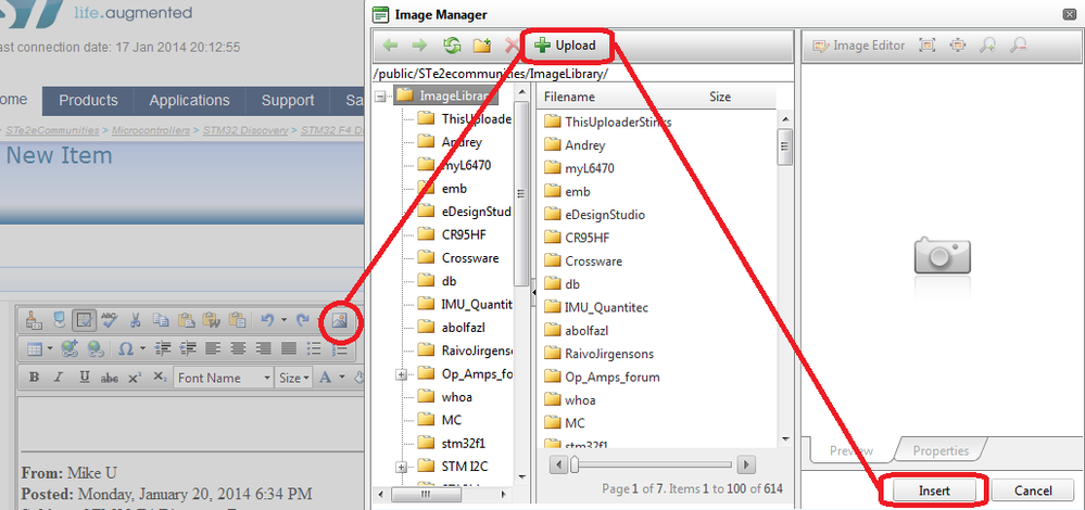

. in the #if defined (STM32F401xx) block. That makes me think there is some incompatible combination of #defines.Argh! I don't know why this is so hard! It's supposed to be a canned demo for this Discovery board.I will keep trying stuff in a semi random way.Mike As an aside how do you get pictures to show up in the body of your post?2014-01-20 12:55 PM
