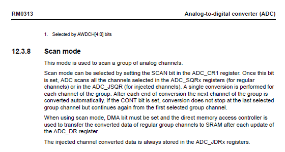

2015-03-12 10:22 AM
Are you saying that SCAN mode is not to be used for a regular group conversion? Because if so, how does the ADC know to convert a group? Here is what the reference manual says:
2015-03-12 11:10 AM
Making the change on the timer trigger configuration fixes the single-shot issue!
No problem, but I have stripped you of your IC Validation merit badge.Are you saying that SCAN mode is not to be used for a regular group conversion? Because if so, how does the ADC know to convert a group?You have a ''group'' with ONE member, I'd advise you not to scan it. If you have more than one channel, then yes scan them.2015-03-12 11:45 AM
Sure - that's fine. This was a hold over from copy pasting code and deleting what wasn't necessary to generate a stripped down example that works.
But the SCAN bit is still. . . unclear. Reading that, I can see a couple interpretations:1. Setting the SCAN bit will trigger a conversion of a group once. If I read the bit, it will read back 1, but if I ''set'' the bit again, it will trigger another conversion of that group, also once.2. In order to convert a group, one must set the SCAN bit, then trigger conversions some other way.You're correct to take away my IC Validation merit badge. I need to spend more time exhaustively experimenting with all possible meanings of the RM text before I declare the chip as defective.2025-04-17 3:13 AM
