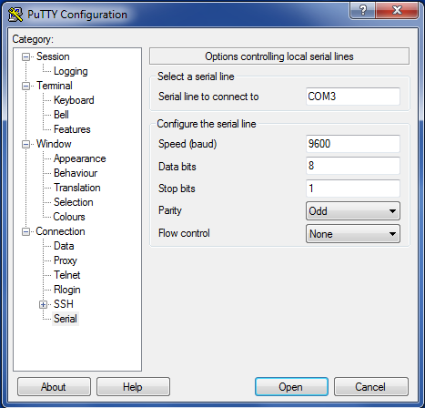

I'm working on STM32F103 RB microcontroller, I've download STM32CubeMX and STM32CubeF1 .I want to show a message on my computer, thanks to a terminal, which I code on my STM32.I know that an example exist in the STM32CubeF1 but I don't succeed to enable and show the messsage on the terminal.I use Putty for the terminal and configure as thay say.Q1: What terminal can I use to do what I want?

package is the following : STM32Cube_FW_F1_V1.4.0\Projects\STM32F103RB-Nucleo\Examples\UART\UART_HyperTerminal_DMAWord Length = 7 Bits
- One Stop Bit - Odd parity - BaudRate = 9600 baud - flow control: None-Nesrine-

and thanks for your help, Yes you're right I talked aboutSTM32F103RB-Nucleo board,however I think that the word lenght has to be on 8 bits (8 Bits = 7 data bit + 1 parity bit).

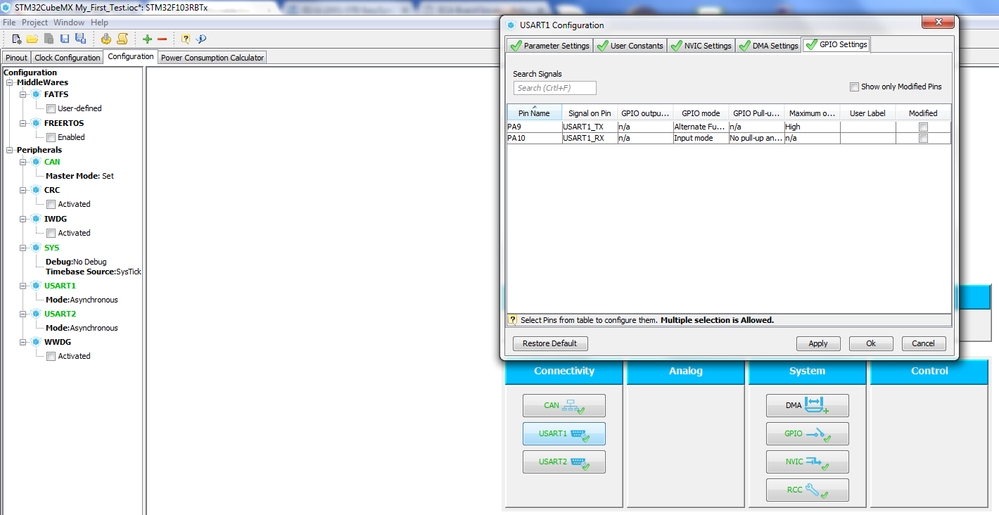

In fact, I have just an USB-to-microUSB connector but not anUSB To Serial Adapter. I think this
http://www.mouser.fr/ProductDetail/Gravitech/USB-SER-NANO-5/?qs=sGAEpiMZZMvq007EO%252bXAYYlbvgKp85ZE

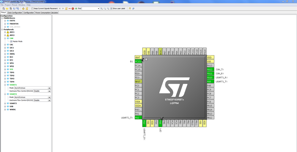

should work for the UART.My configuration is the following one :-Nicolas-

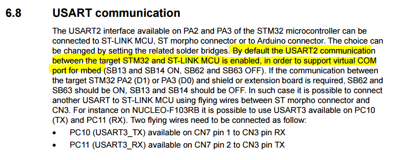

Well, if you have a Nucleo board, you have an advantage, the ST-Link microcontroller that is embeddedfor programming works not only as ST-Link but generates a virtual serial port also (Cool, don't?), for fast testing is really good and helpful, because you don't need an external USB-Serial converter. If you are not quite sure about how to use it, you can refer to the Nucleo's user manual (UM1724), page

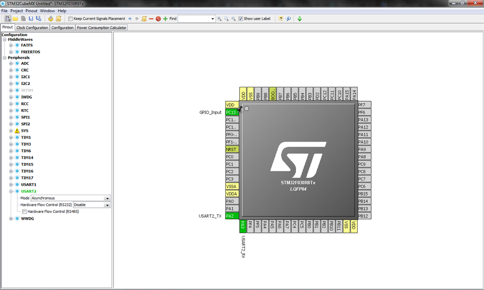

So, for a fast testing, as said in the user manual you have to configure USART2 in pins PA2 and PA3. I'm going to show you a little example about how to use the CubeMX and how to make a test code for System Workbench, I'm using a F030 Nucleo board, but in the practice works same.

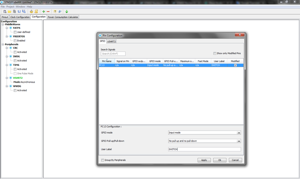

In the Cube, select the micro an create the new project, and cofigure the USART2 in pins PA2 and PA3, also configure pin PC13 for the user switch as GPIO input.

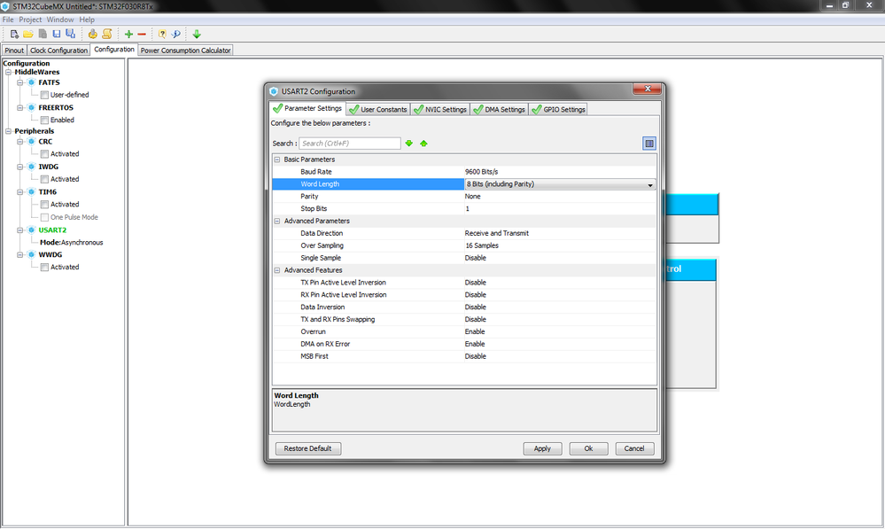

After that, go to configuration tab and configure the peripherals: USART2 at 9600bps, 8 bits including parity
, parity none, and 1 stop bit. And name your GPIO, I'll call it SWITCH.

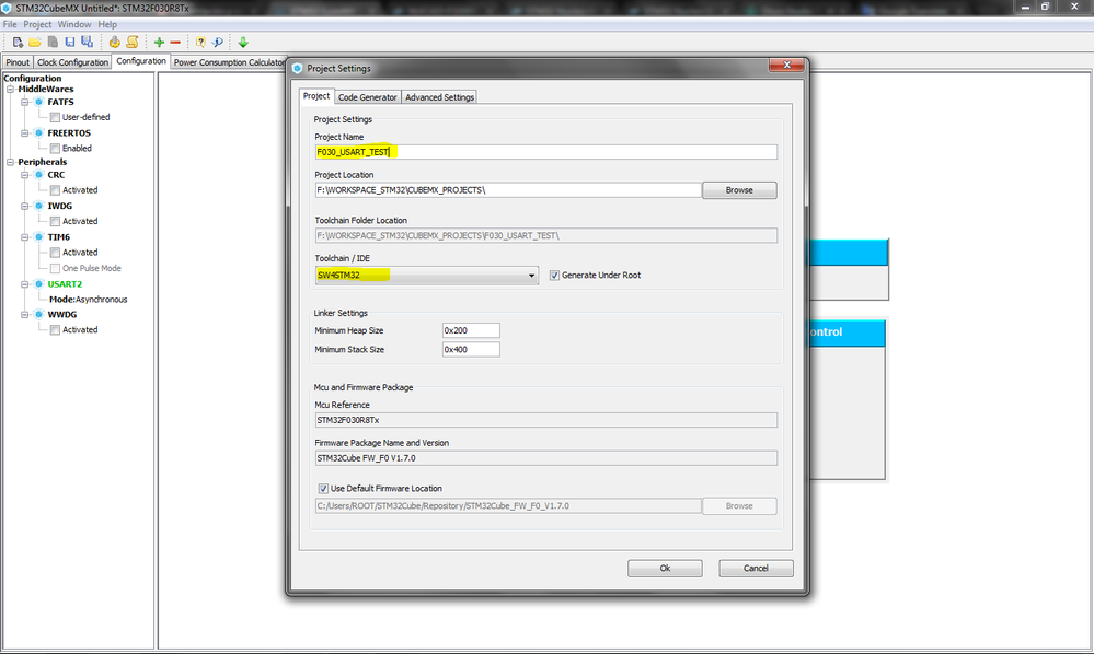

After that configure the outputs of the project, choose you IDE, I'll select SW4STM32, and name your project:

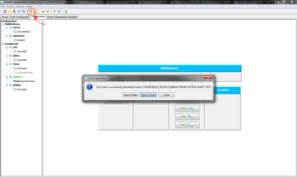

And after that generate the code:

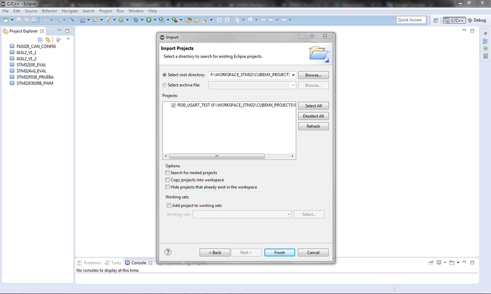

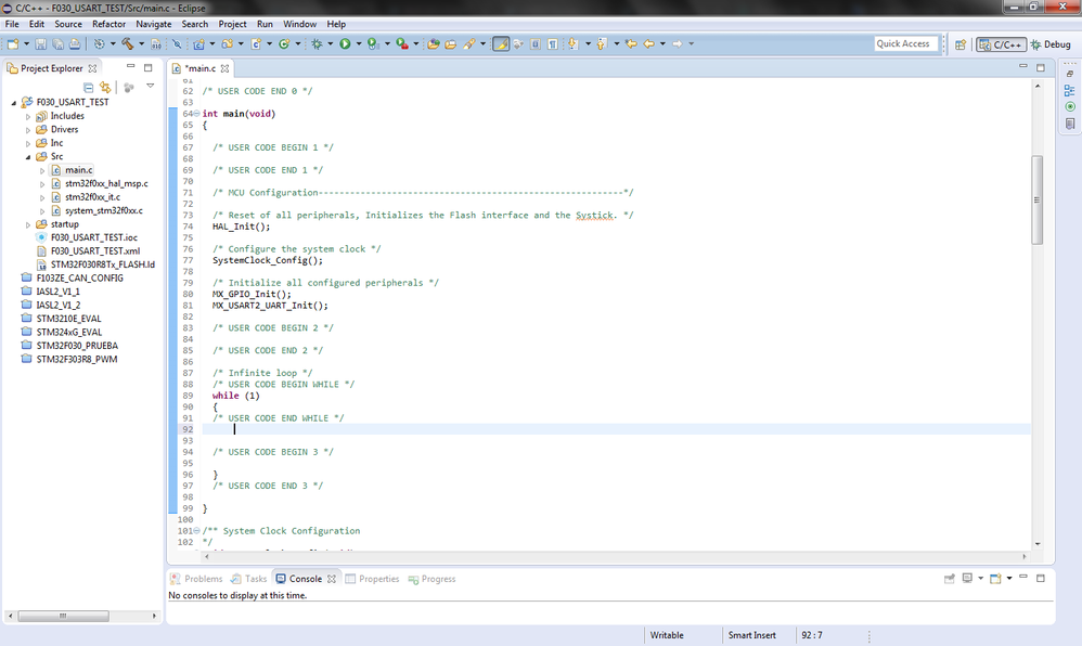

Well, now pass to System Workbench, and import the code to your workspace:
After the project have been imported, open the main.c file that is in Src folder, and enter to stand on the mainline:

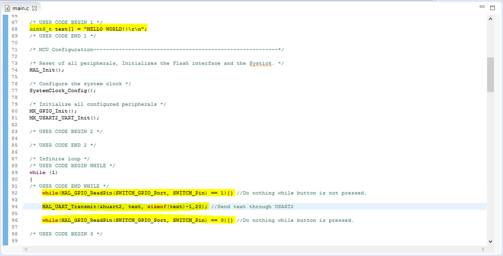

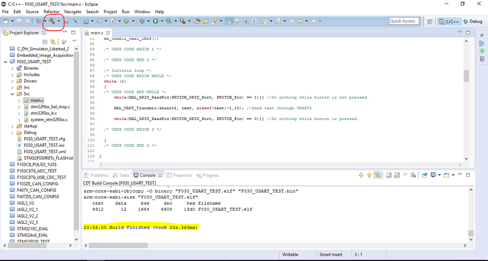

As your peripherals are initialized, you can use those rigth now with the HAL libraries, so, I want that when I press the switch, send a message, and don't send anymore while is pressed, so I declare a char array for the text and make the code, the switch button is normaly High, and when is pressed goes to Low. For the uart, past the arguments that are on the figure, be sure that timeout be enough to send all the characters (20ms)
With those code lines now is time to build the project, just make clic on hammer:
