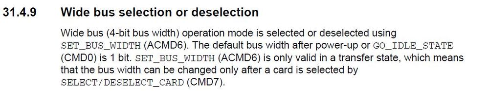

The 4-bit SD Data Transfer Mode is Mandatory for High-Speed Cards, Optional for Low-Speed ones, so it depends on the used uSD card type. Otherwise, it's better to configure first the 1-bit SD Data Transfer Mode:hsd.Init.BusWide = SDIO_BUS_WIDE_1B;
And then, just enable wide operation, for the 4-bit SD Data Transfer Mode:
HAL_SD_WideBusOperation_Config(&hsd, SDIO_BUS_WIDE_4B);
Here below some screen captures from the RM0090 reference manual:
