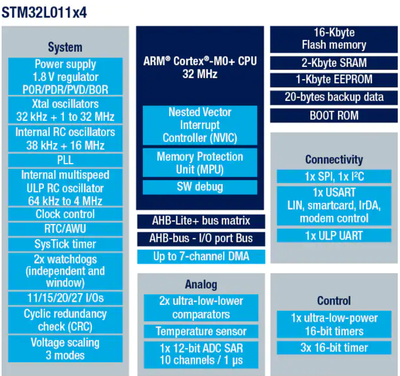

I'm looking for an mcu that can both do USB DFU programming and has and external crystal which there aren't many cheap available now (or would drop the external crystal requirements if I'd get convinced otherwise because I want it as stable as possible) for industrial application.
Now in STM32L011K4T6 datasheet page 13 there is a mention on crystal less USB operation, what does it mean? is there a way to somehow use USB to program this MCU without an st link?
also what should I be looking for when checking if an stm32 supports connection of external crystal without bypass mode using 2 MCU pins like you normally expect? and how stable and reliable are the new crystal less MCUs that come out in comparison to old ones with externally connected crystals?

Well it seems like the USB "type" of the L0 series is a bit different from the rest so my question was more towards what are the procedures to make it work on say "STM32L011K4T6" because it doesn't have that "Enable USB 2.0" option the other more "Main stream" MCU's have...
2023-08-20 3:44 AM
Correct. STM32L011 does not have USB.
2023-08-20 4:50 AM
+1 to what Pavel A. said above.
Copypaste error. I believe we've discussed exactly the same in the near past, maybe other 'L0x1 (USB is indicated by 2 or 3 as the last digit).
