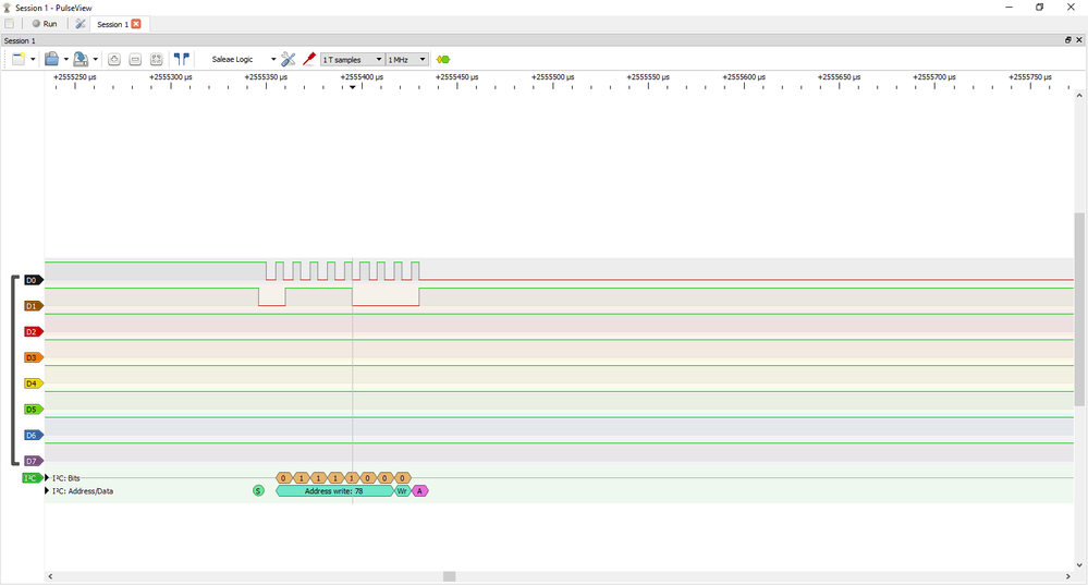

My problem relates to I2C communication when trying to send bytes to a display on address 0x78. First I tried with the plain I2C HAL function(blocking), but I realised that the MCU gets frozen because of the huge amount of data to be sent (8192 bytes). At that point I decided to go for using DMA.

HAL_StatusTypeDef status = HAL_I2C_Master_Transmit_DMA(&i2c3Handle, 0x78, buffer, sizeof(buffer)); //S2ST(1)Above you can see that I've crated a short snippet to check whether those five bytes are sent out well, but the outcome was different.
All in all I always experience that only the address bytes is sent out and SCL channel remains low, in addition to that I saw during debug that the I2C transmit is still taking place, like it was waiting for bytes to send out but nothing comes.
I had no opportunity in the past to deal with DMA so probably I am missing out on something.
Thank you for your help in advance!
2020-07-19 9:00 AM
Your scope trace shows you're writing to slave address 0b0111100 = 0x3C, not 0x78. Address should be shifted left one bit. I'm not sure why the plot says "Address write: 78". Seems misleading.
