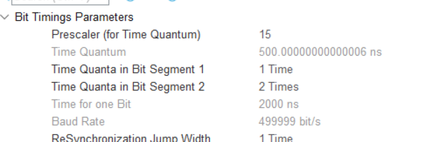

I am trying to send messages from Can1 to Can2 in an stm32f205vet6. HAL_CAN_AddTxMessage is returning HAL_OK but I am not able to receive any messages in CAN2. And I cant see any messages transmitted in a scope.
clock speed = 120Mhz
Can speed = 500 kbps
My code below

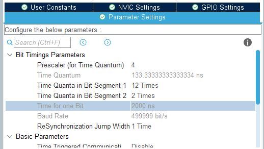

For Clock 120 MHZ on the APB1 peripheral clock You have max 30 MHz for CAN
So I propose change settings as below:

2023-04-21 2:27 AM - edited 2023-11-20 7:32 AM
Both CAN uses the same bit time parameter, the CAN1 and CAN2 init code are auto generated to get 500kbps
2023-04-21 3:56 AM - edited 2023-11-20 7:32 AM
