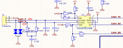

I have waisted 2 days already on trying to figure out why interrupt is not being triggered when using CAN RX.
I started new fresh project just to test the CAN and debug it so there is not much initialized here.
So sending data via CAN works for me but when I want to receive it the interrupt never triggers. I have tried with filter and also without ! (didnt know if that maybe has something to do with it) I also have ground connected to my CAN PEAK so that shouldn't be an issue also. I think I initialized all interrupts correctly. I should also add that I created everything with cube IDE .ioc. Any ideas or help will be appriciated. Here are my files:

Also please provide what tranceiver part number you're using? what board are you using: ST or custom board?
2024-05-16 7:04 AM - edited 2024-05-16 7:05 AM
2024-05-16 7:10 AM
As far as transciever part number goes I dont really know what you mean by that.
This is an important part of the the HW part of the CAN.
Do you have schematics of that custom board?
Also better to attach your project (a very simple project that includes the CAN communication and nothing else).
2024-05-16 7:16 AM - edited 2024-05-16 7:17 AM
Cannot attach full schematics because of NDA. This is the CAN part. CANTX and CANRX go from processor pin 32 and 33 and from there to the picture below. I am using HSE 25 MHz and LSE 32 kHz. Thats it from CAN part
2024-05-16 7:43 AM
