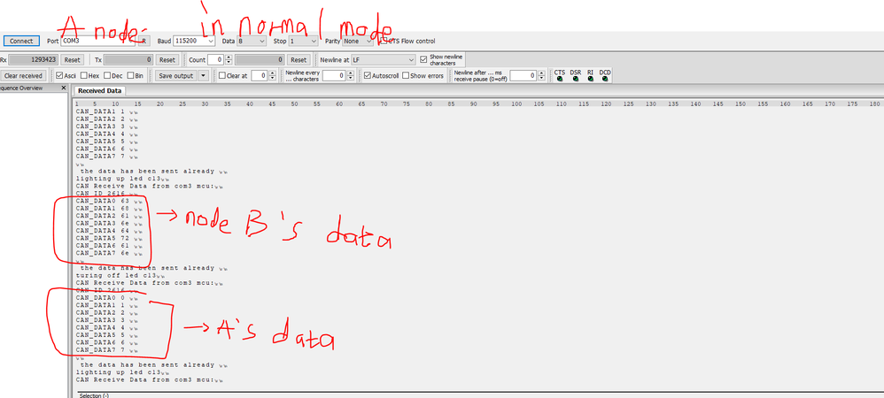

I have 2 nodes, A and B, they set filters for both, now A is sending data frame, B can receive the data from A. but A originally can receive data from B, but after around 1-3 mins the receiving data mainly from itself, minorly from B. but if i reset the board, node A will receive B's data for a while then change to the status:(majority its own data, nimority B's data).
