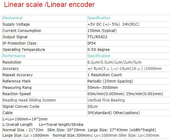

I'm not sure I'm allowed to put commercial link on this forum
Here are information that I have

This is the other tricky part.
Encoder pulse: 512 pulses per mm, hence 1.95micron per pulse
DRO can accept multiple resolution: 0.1 mic, 0.5mic, 1mic, 2mic and more.
I was thinking about using 0.1mic resolution and adjust the remaining error with DRO software or live with that error which is very very low, this is for hobby use, not professional purpose. hence when i receive 1, I send 19 pulses.
I need to pay attention to the limit of the STM32 regarding number of pulses sent in a short time. If it's not powerful enough, I can decrease the resolution.
And also, for fast traveling moment, I have the Z reference each 25mm hence each 12800 pulse in
