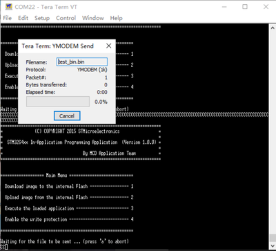

Now I am also designning a IAP for STM32G474VET6, I have the same issue as you I think, when I start to transfer bin file with tera term, the transfer stopped and I step into the code, it seems UART_Receive time_out
I did this design according to AN4657. the tranfer with tera term as below
I also used uart1, I am sure it can work, because i received the menu and send 1 for choosing download.

@dqsh06 I have tried every option possible but couldn't find the solution.
I do get the menu and it waits for the binary file when pressed 1.
