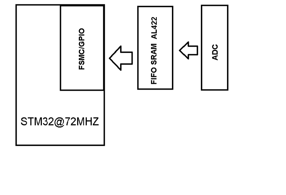

thank you i just want to maje low cost oscilloscope
and i want to get the maximum sample rate with stm32 what is the best connection interface type between adc and stm32?2016-01-24 8:11 AM
Well IRQ's are going to top out at a few hundred KHz
FSMC Might deliver 9-12 MSps, but you have a very small capture buffer.The DCMI on the F4 might offer 54 MSps.You might be able to get significantly higher rates with CCD/FIFO arrangement to handle the disparity between the high sample rate, and lower/smaller processing rates.2016-01-24 9:34 AM

There are certainly chips in that domain that can get you to speeds and capacities beyond the performance of the STM32 itself
http://www.glyn.com/data/glyn/media/doc/AVERLOGIC_product_overview_07092010.pdf
You'd have to determine the goals for speed, width, depth and cost.2016-01-29 8:25 AM
the goals for speed
is take afew sample to draw it in lcdwidth
i will use 2 adc 8bit
''16bit''
inInterleaving ADC
mode to increase speed timedepth
if you mean the sample recording length 1kbyte is enough
but the problem know clock source ? how to get HW clock out from stm32 and it must change apple2016-01-29 9:00 AM

The integer clocking schemes of the STM32 aren't what I'd call flexible. You can output internal clocks via PA8 (MCO) or from TIMx_CHx pins. With a FIFO you could use totally different clock rates. If you needed a lot of control and NCO or DDS would work. 1KB seems very little data.We’re moving the ST Community to a new platform to give you a better and more reliable community experience.
