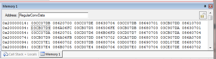

I am working with stm32F0 ADC & DMA peripherals and i have to convert 4 channels.The ADC is triggered by the Timer1.
My problem is that i obtain the result correct but there is a permutation between 2 channels(the second & the 4th).So is any one have an idea to help me resolve the problem.

esraf posted a similar, but not identical, problem on this forum 1/2/2013. Martin D replied that when the F0 ADC is calibrated, DMA advanced one position forward in the memory buffer. Go read esraf's post and see if that helps in understanding. And check the errata for your processor version to see if this is mentioned.

Thank you very match ,the problem was resolved.Just the calibration must be done before the DMA initialization to avoid the DMA memory increment.
