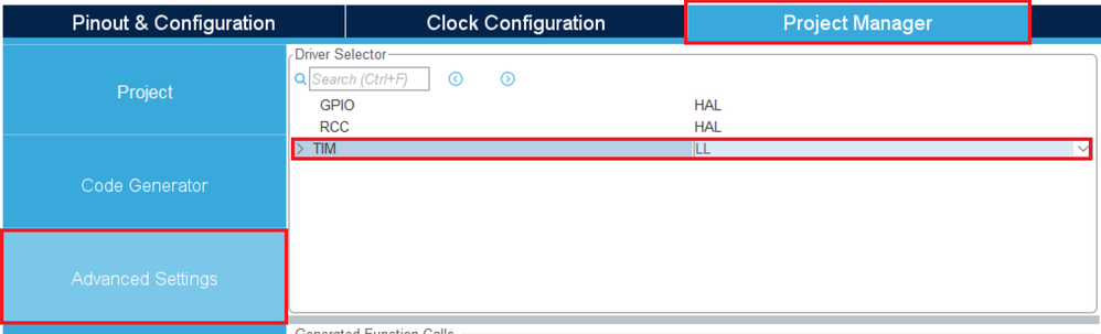

Hi @YLi.13​ ,
Yes, you can use the STM32cubeIDE to generate Tim_Encoder project with the LL library.
After configuring your project with STM32cubeIDE, you can click at project manager/advanced settings and choose to use LL drivers in driver selector as shown in the below figure.
_legacyfs_online_stmicro_images_0693W00000bhfSoQAI.pngDoes it answer your question?
If your question is answered, please mark this thread as answered by selecting Select as best, as also explained here. This will help other users find that answer faster.
Thank you.
