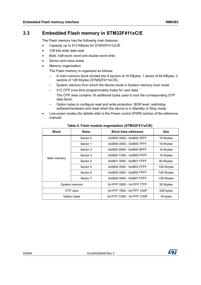

I am searching for hours, could not find a document about flash sectors sizes other than int
the sample header file /STMCUBEF4/STM32Cube_FW_F4_V1.18.0/Projects/STM32F411E-Discovery/Examples/FLASH/FLASH_EraseProgram/Inc/main.h. Is this information somewhere specified in any pdf's or documents.Thank you#define ADR_FLASH_SECTOR_0 ((uint32_t)0x08000000) /* Base @ of Sector 0, 16 Kbytes */

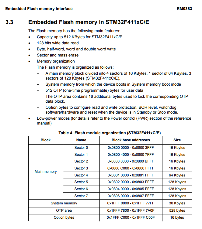

Hello
marrius9876
,You can find the flash sectors sizes in the reference manualrelated to your device (
)Best Regards
