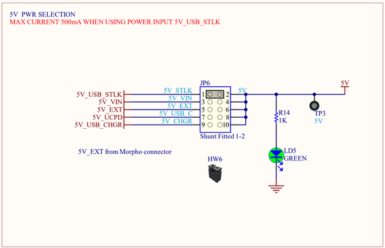

Based on the schematic, I tracked how the power was supplied to the board and discovered that 1.0~1.1V was coming out from 5V, by testing pin TP3.
Since 5V_STLK and 5V are connected by default, the 5V_STLK was also approx 1.1V.
So, I removed the connector that connects 5V_STLK and 5V and checked again, figuring out that 5V_STLK worked properly as 5V.
Therefore, I'm supposing there's some short circuit connected with 5V.

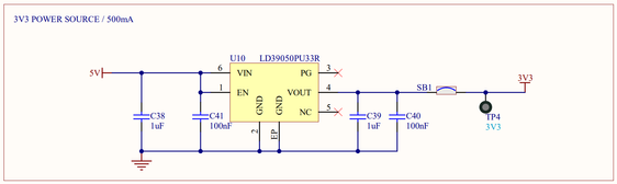

I think this LDO has a problem because when I plug the USB C cable and switch the power selection pin header from 5V_STLK to 5V_USB_C, it suddenly heats up very high.
I get a decent 4.7V output from 5V but a 0.5V output from the 3V3 node.
I'll try some more and share the results.

It could be U10 that's the issue, but it could also be something downstream of that on the 3V3 line. If something downstream is shorted, then U10 heating up is expected.
