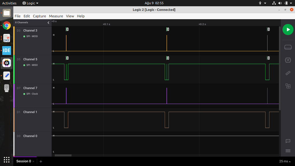

Zoom out view of logic analyzer. channel 1 is slave select pin that is configured manually as GPIO output not hardware NSS for master side. I configured hardware NSS input from cubemx for slave side0693W00000D1qidQAB.png

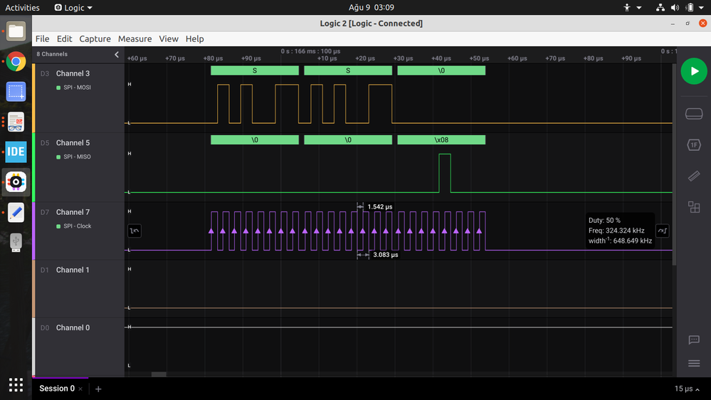

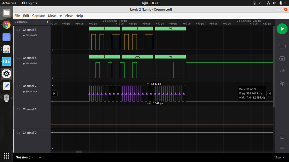

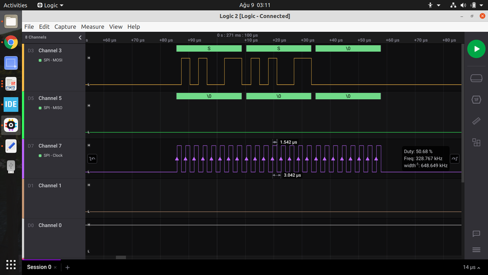

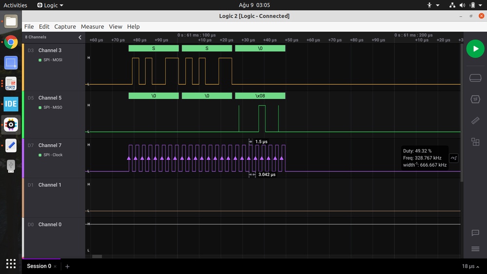

Zoom in views of some transmission and reception datas. I used just "SS"(actually 'S','S','\0') string from master to slave and slave to master. Thus 3 datas will be seen every transmission and reception. MOSI datas are good and MISO datas were changed every time. I showed below pictures.
0693W00000D1qk5QAB.png0693W00000D1qkeQAB.png0693W00000D1qlIQAR.png0693W00000D1qkoQAB.png
