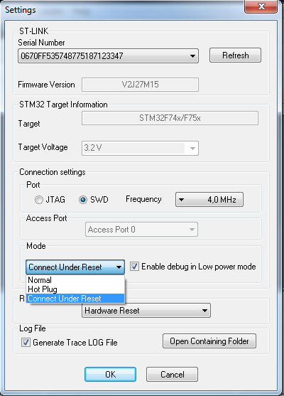

,The “connect under reset�? option is available with ST-LINK/V2, it
allows to connect to the target before executing any instruction:
STM32 ST-LINK utility
GUI version
STM32 ST-LINK utility command line interface (CLI)
:[UR]: Connect to the target under reset

I am aware of the 'Connect Under Reset option'. This is not what I am looking for - when used, NRST output of STLink goes down during the connection phase, but the the debugger puts the core into halt and releases the NRST line, so the resulting behaviour is a short pulse.
Simply put, I'd like to have a tickbox (or command for CLI) which directly sets and/or releases the NRST output of STLink.
Rationale:
In larger systems, the mcu reset is connected to reset inputs of other chips. During debugging, sometimes it is needed to hold the whole system in reset. Once this line is connected to STLink, it would be an added bonus if it could be directly manipulated from PC.
Thanks.
