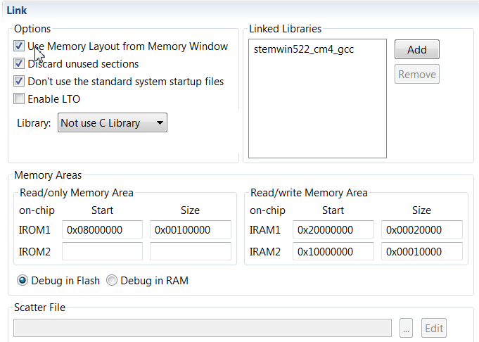

I have successfully compiled and linked my stemWin project: Note that in coIDE I have set the compiler settings for FPU to ?FPU Hard?:
GCC HOME: C:\CooCox\GNU Tools ARM Embedded\4.7 2013q3\bin

the linker script and the placement of data in the external RAM? The word ?external? has caused my 72 year old brain to sunder. I am using a ST32F407VG discovery board (only) with a DM-LCD35RT screen with a display controller SSD2119 (standard add-on to embest base board). I do not have a arm-gcc-link.ld file as I have:
That is about it. The main.c is a small string example for testing. To complete here is one of the greatest marketing spins of all time:
