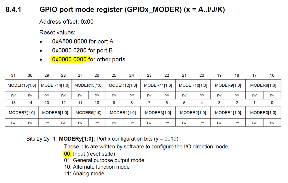

This information is in the reference manual. Look at the GPIOx register settings.
Most pins are set to high impedance input mode with no pull with a few exceptions for pins used for programming.

They are not "UART pins" during/after reset.
One of the side effects of a reset is to revert periperhal registers to their default (reset) value.
Check the GPIO peripheral register documentation, and those of the involved system config registers.
