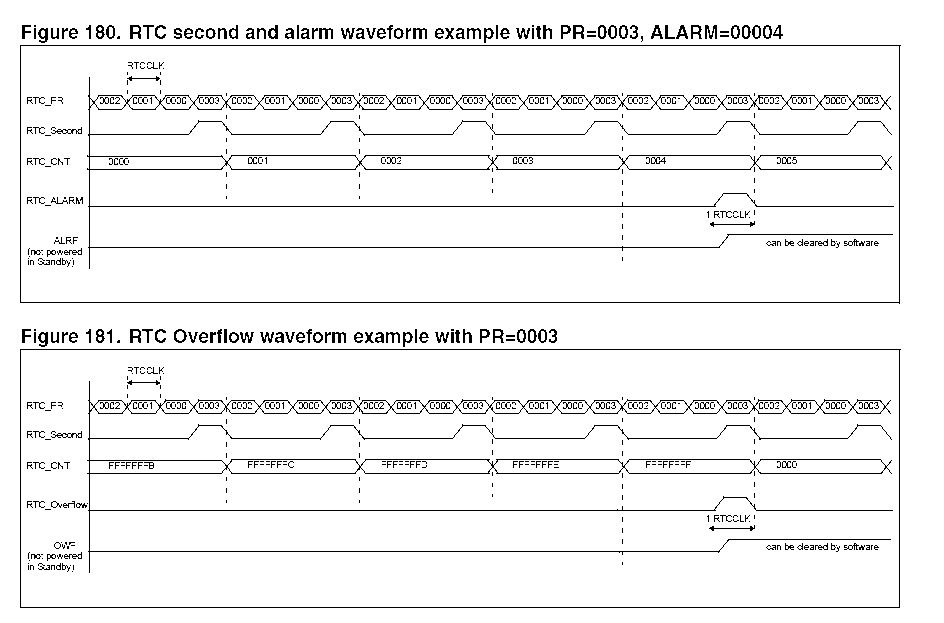

Does anyone has any idea how can i get the source of wake up from standby mode? I use only RTC and wake up pin. I found a WUF bit in PWR_CSR, but problem is that this bit is for both events. Thanks for any idea2013-04-10 8:17 AM

I tryed to catch the RTC_FLAG_OW and RTC_FLAG_ALR.. In data sheet are these figures:
LCD_DisplayStringLine(Line7, ''RTC_FLAG_ALR on'');
if (RTC_GetFlagStatus(RTC_FLAG_OW ))
LCD_DisplayStringLine(Line8, ''RTC_FLAG_OW on''); But it always shows that flags are set on 0.
