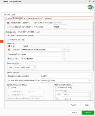

To test this , i disabled the SWV from the debug configurations, but the LED did not light up, and when i placed a break-point on ITM_SendChar(), it hit that breakpoint.

Checking DHCSR.DEBUGEN does confirm debugger presence, but in my use case, that alone isn’t enough.
The issue I’m tackling is that even with a debugger connected, ITM/SWV tracing might not be enabled or configured properly. In such cases, calls to ITM_SendChar() inside _write() will still run inside the for loop — wasting CPU cycles even though nothing gets output via SWV.
So I also tried checking:
However, these registers still report as enabled, even when the trace output isn’t showing up — i.e., the SWV output window in the debugger remains blank. So the condition passes, but no actual data is transmitted. That’s what led me to post this question in the first place.
