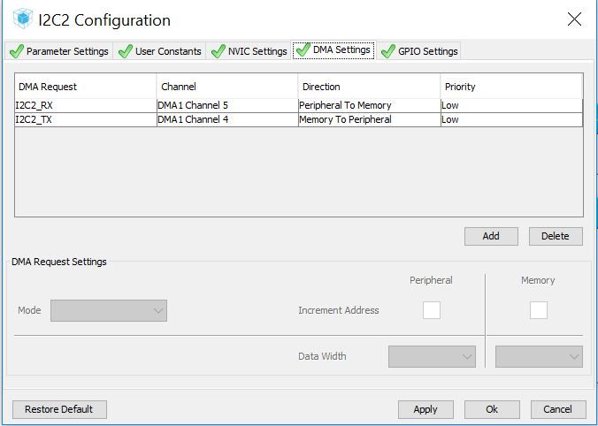

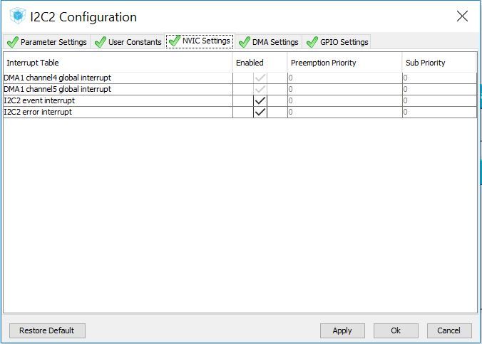

Hi I'm trying to run I2C in DMA mode with LIS35 (accelerometer). I wrote simple code as below but each time when I try to run or debug it I'm getting back return ''LIS35_ERROR;'' which means that LIS35_I2C_Init(void) function goes wrong.
Previously (I mean yesterday) I wrote two similarly projects:
> First was based on HAL_I2C_Mem_Write /
HAL_I2C_Mem_Read functions
- and all works properly (return LIS35_OK;)
> Second was based on HAL_I2C_Mem_Write_IT / HAL_I2C_Mem_Read_IT
functions
- and all works properly(return LIS35_OK;)
Environment:
- STM32CubeMX - updated today,
- Board - Nucleo-F103RB
- CubeMX project added as attachment
- I2C configuration al on pictures below
current code:

Thanks in advance for any help :)

TJ thank you for your fast reply. There is no need to use interrupts in this case but it will change nothing. I have a need to use I2C in DMA mode, example code is above but don't works, and I have no idea why.
Additionally as I mention (also)above I have ready code based on 'blocking mode' as yours exaple (
HAL_I2C_Master_Transmit
) (and I agree with you - This mode is simple and nice), my question is how to use I2C in DMA mode.BR's,
Frank

Do you see any change in your counters (cntTx, cntRx)?
I have a similar non-working issue with I2C mem Tx with DMA, and I think I have found bugs in the HAL driver code but require more investigation. Your answer to the above question will help, also do you have any other debug information? Are the I2C callbacks activated by DMA transfer complete (Rx and Tx)? Do you know the state of I2C at failure eg I2C_Tx_Busy or I2C_Rx_Busy, and do you have a logic analyzer or DSO to monitor SCL and SDA?
I will post a separate topic on what I find with my application, even if there are no bugs in HAL code there are many traps to be aware of that may help others.
