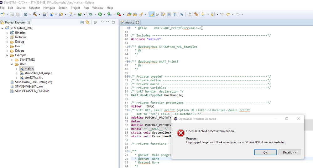

I cannot dbg and programming stm32446e-eval board using onboard st-link, pic below. I checked also other board stm32f769i-disco and its working fine on the same enviroment.
Log:
Unplugged target or STLink already in use or STLink USB driver not installed
Open On-Chip Debugger 0.10.0-dev-00278-ga53935e-dirty (2017-05-09-09:25) Licensed under GNU GPL v2 For bug reports, readhttps://community.st.com/external-link.jspa?url=http%3A%2F%2Fopenocd.org%2Fdoc%2Fdoxygen%2Fbugs.html
srst_only separate srst_nogate srst_open_drain connect_assert_srst Info : The selected transport took over low-level target control. The results might differ compared to plain JTAG/SWD adapter speed: 4000 kHz adapter_nsrst_delay: 100 Info : clock speed 4000 kHz Error: open failed (no matching adapter found) in procedure 'init' in procedure 'ocd_bouncer'How to fix it ?

Make sure it works with the ST-LINK Utilities, and check the firmware version is current.
OpenOCD may be checking for a chip ID it doesn't support, in which case you should get a current build that does.

Hi I found bug on my PC motherboard. When I use USB 3.1 its not working, when USB 2.0 interface everything is ok. EVB is supply both cases on ext PSU.
I have ASUS RAMPAGE V EXTREME.
