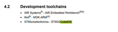

You can debug using CubeIDE also: (according to the UM2448)
Best Regards.
