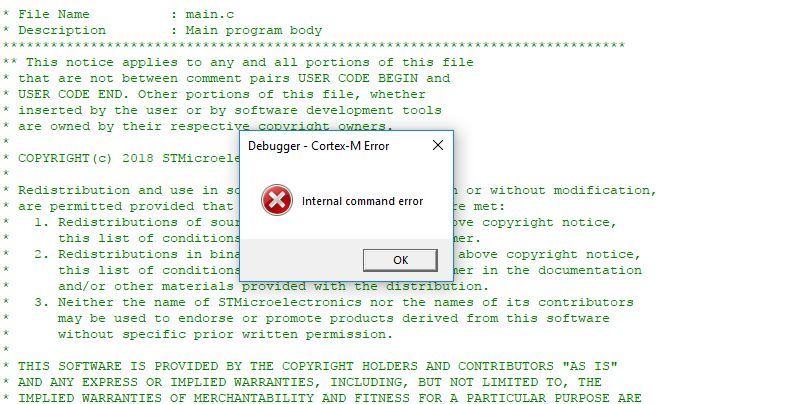

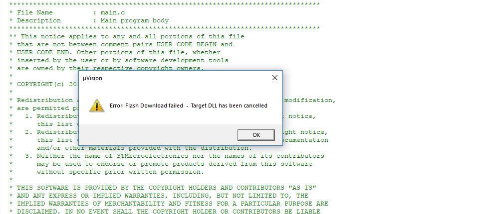

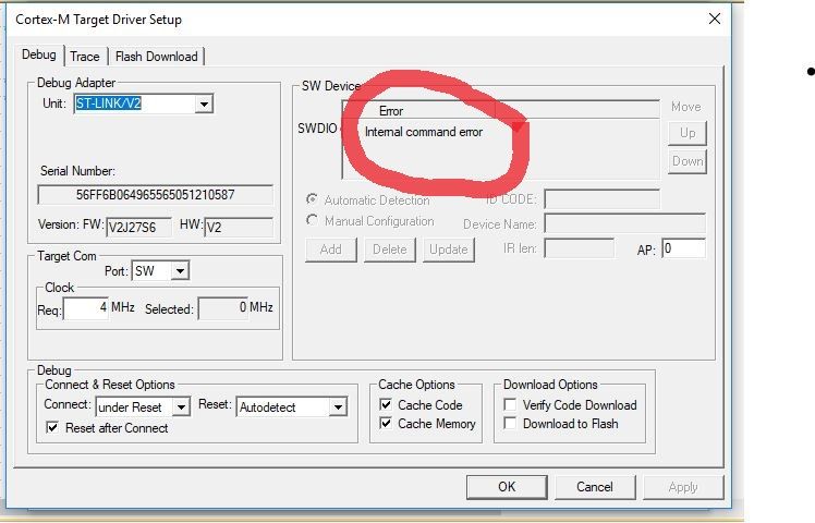

I am getting the following error. Can you please suggest what is the problem?

Run ST-Link utility - check the firmware freshness - the current is : V2J28S7
Check cables.
2018-01-27 7:38 AM
What exactly is the context here?
What board? What chip? What type of ST-LINK? How is it connected? Did it work and then stop?
Can you access chip if BOOT0 is pulled High?
Does your code go into low power modes, or reconfigure GPIO/SWD pins?

I looked into:
'On ST-LINK/V2 boards, update the firmware to the version
V2J27S6'
so assumed that st-link is V2 version.
