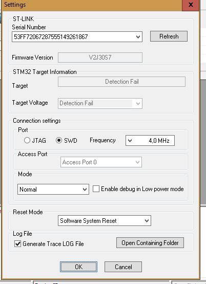

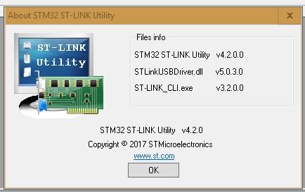

I have link V2, which is also updated to the newest version. Here are 2 pictures.

Attach the log - the messages you see just after starting the ST-LINK utility. You will versions of the firmware there, and ST-LINK HW version (I mean the chines device you connected)

Not sure what you mean. Utility's and ST-Links ID's are there. ST-Link is bough from Digikey and it should be genuine.
On the back of the ST-Link it says 'B 2017 03', 'ST-LINK/V2', Made in China, RoHS text, big ST logo and CE logo.
Are these the logs you meant?
