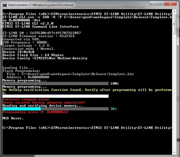

Is somebody could say me if there is some issue with ST-Link CLI to write bin file? Command doesn't take the address parameter 0x08000000 and try always to write at 0x00000000. Please see my screenshot below. Thanks Tesca PS: I try with [] soround address and without, but it's the same problem.2015-06-02 6:30 AM
Hi Tesca,
Please try with the following line command and let me know by results :''ST-LINK_CLI.exe'' -c swd -p ''c:\Users\gen0\workspace\Template\Release\Template.bin'' 0x08000000 -Rst -v
Best Regards, Nouha2015-06-14 2:18 PM
Hello Nouha,
sorry for my tardiness feedback. It works with the quote around the bin file name. I shame to not had try this myself :( Thanks Tesca.We’re moving the ST Community to a new platform to give you a better and more reliable community experience.
