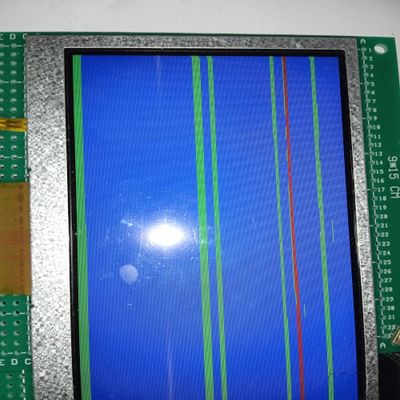

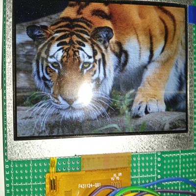

hi,
I have successfully connected LTDC display(480x272) with STM32H723ZGT6 - RGB565 mode .
I could able to image file from internal Flash Memory .
I could able to Load Perfect colour from DMA2D by using. framebuffer in global level .
uint16_t framebuffer[480*272];
HAL_DMA2D_Start(&hdma2d, 0x000FF000,(uint32_t)framebuffer, 480, 272);
HAL_DMA2D_PollForTransfer(&hdma2d, 10);
I could not able to transfer colour from SRAM to LTDC by using .
for (int y=0; y<272; y++)
for (int x=0; x<480; x++)
framebuffer[y*480 + x] = 0xF800;
Erratic fill Screen happening when i transfer data to frame buffer memory . Even i reduced the speed of LTDC and total clock but nothing worked out .
DMA2D using same frame buffer memory and transferring register to Memory and working fine .

2024-11-08 2:47 AM
Hello @MMARI.1 ,
could you please share your code as this description is not clear to me.
I could not able to transfer color from SRAM to LTDC by using.
in this case is the frame buffer declared in SRAM ?
also, I would recommend you check 4861 section 7.2.5.
Regards
2024-11-10 12:10 AM
How to separate the SRAM- d1 exclusive for LTDC frame buffer . how i can directly assign the SRAM address in the LTDC Frame buffer setting . 255kb size required for frame buffer . i can't assign the staring address the of SRAM- D1 because mcu using some initialization data's . what should i have to include and modify in the linker file for Dividing the SRAM-D1 in to 2 .?

2024-11-10 12:42 AM - edited 2024-11-10 12:59 AM
Primary change two lines to by address mode :
//uint16_t framebuffer[480*272];
#define FBUF 0x... //reserved memory add start in Dx must be alligned for ltdc limits
pLayerCfg.FBStartAdress = (uint32_t)FBUF;
and in linker script setup RAM areas and sizes .
But when DMA2D into actual buf works, then maybe other mistake in your config. Check MPU and optimize level can remove your code , because filled p_buf is never used... change it to framebuffer and declare volatile.
