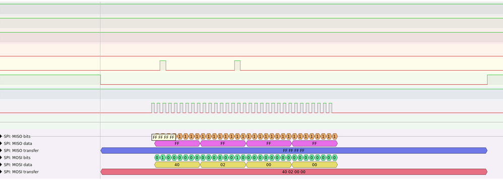

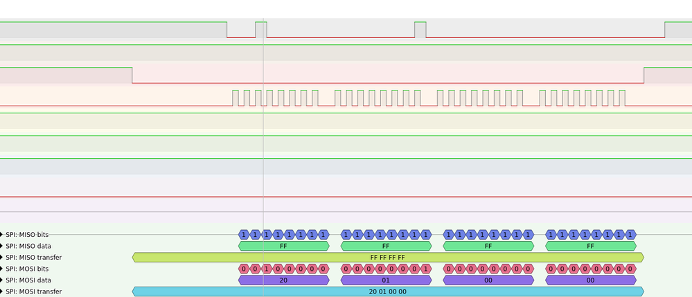

4 bytes frame on Rpi, matches code:
4 bytes on STM32 (should match above):
It can be seen that it appears the bits are shifted 1 to the left here.

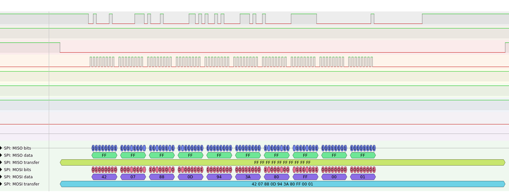

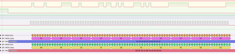

The 10 byte frame:
Same again with the STM32:

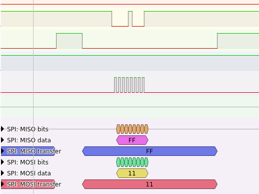

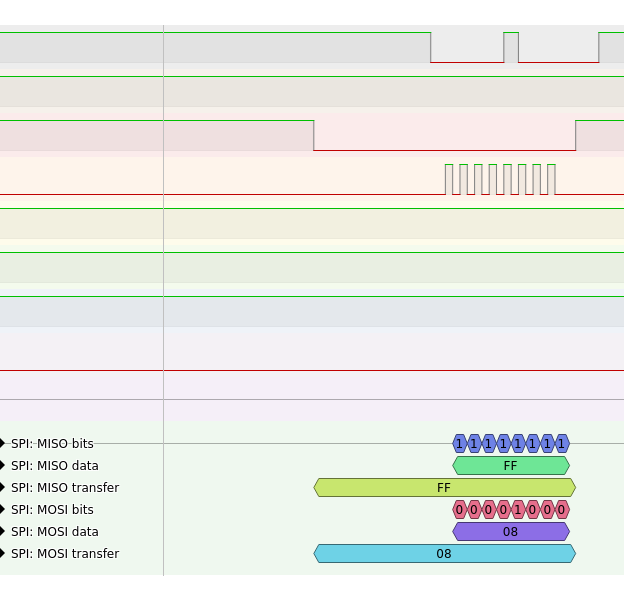

The final frame is a single byte, the number '8'
On the Rpi it looks like this:

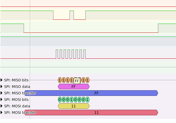

The STM32 reads this as 11
Here it looks like the CS line line stay low for too long causing a 1 to be read, where in the RPI it can be seen that CS goes high right at the end of the last byte.

2022-06-23 7:51 AM

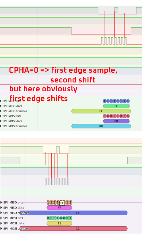

There are 4 SPI modes, set by 2 bits, traditionally called CPOL and CPHA. Read the SPI chapter in RM.
You set them
hspi1.Init.CLKPolarity = SPI_POLARITY_LOW;
hspi1.Init.CLKPhase = SPI_PHASE_1EDGE;
i.e. CPOL=0, CPHA=0, and the SPI waveform conforms that.
The RPi waveform does not conform that, it is obviously CPOL=0 CPHA=1, and the LA is set to this mode, too.

2022-06-23 9:16 AM
Interesting. Thanks for that. I should have drawn the lines, but I wasn't aware of workings of CPOL and CPHA. Confirmed that with my Logic Analyzer setting CPOL=0 and CPHA=1 decodes the Rpi. Setting CPOL=0 and CPHA=0 properly decodes the SPI.
Now to properly communicate to the peripheral I am not sure if I need CPHA=1 or not. I am going to set up my logic analyzer to determine that but need to rewire some things.
2022-06-23 10:21 AM
Want to close the loop on this for anyone who finds this thread in the future. The above issue is a decoding issue. The difference between the RPI and the STM32 is in fact the CPHA being set to 1 vs 0 (RPI vs STM32)
Once I set the decoder correctly the data was accurate.
I also had to set CPHA to 1 in my code in order to communicate with the peripheral correctly.
