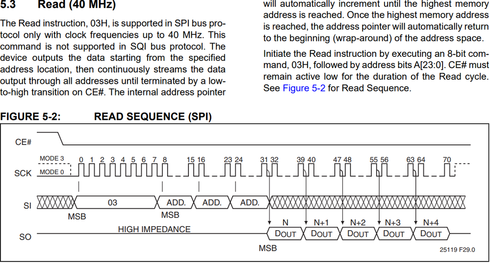

I'm working with STM32F303RET6 and I'm trying to communicate with SST26VF064B (Flash) over SPI.
This is how I configured my SPI (Using MXCuce):

}I was not getting any answer from the flash so I looked at it's pins with a scope and noticed that it's not behaving as the datasheet of the Flash is expecting to.
As you can see in the picture above, once you start communicating with the flash, the CE# goes low and stays low throughout the entire communication.
Now in my case there's 2 problems:
What am I doing wrong?
Thanks in advance,
Rony.

> hspi2.Init.NSSPMode = SPI_NSS_PULSE_ENABLE;
Read in SPI chapter of RM, what does this mean.
Don't try to use the hardware NSS, set it up as GPIO Output and manipulate it "manually".
Don't use a non-static local variable as buffer, it ceases to exist when you leave the function.

2020-07-08 10:01 PM

any way I tried changing hspi2.Init.NSSPMode from "SPI_NSS_PULSE_ENABLE" to "SPI_NSS_PULSE_DISABLE" and it's not the solution for now the CE# goes low and stays low forever.

> I'm not quite sure what the RM is.
RM = reference manual. This is the best source of information on how the chip works.
Go here and select Resources -> Reference Manuals.
https://www.st.com/en/microcontrollers-microprocessors/stm32f303re.html
Jan suggested changing the CE# pin to a GPIO pin and controlling its state manually. I second this suggestion.
Unless you specifically need interrupt mode, I'd recommend using the blocking mode of transmission and it's conceptually easier. Something like:
HAL_GPIO_WritePin(...); // <-- set CS low
HAL_SPI_TransmitReceive(&hspi2, &TX, &buffer, 5);
HAL_GPIO_WritePin(...); // <-- set CS high

This did the trick.
I'm driving the SS manually and then not only there isn't extra pulses in the SS but also the full amount of bytes is being sent as expected...
Thanks.
