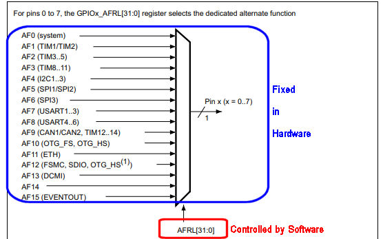

As you can see from the tables, each pin can be configured to a number of Alternate Functions (AFs).
The range of possible AFs on a given pin is fixed in the hardware.
Selecting which one of the available AFs to use at a particular time is done by the software; eg, via HAL functions

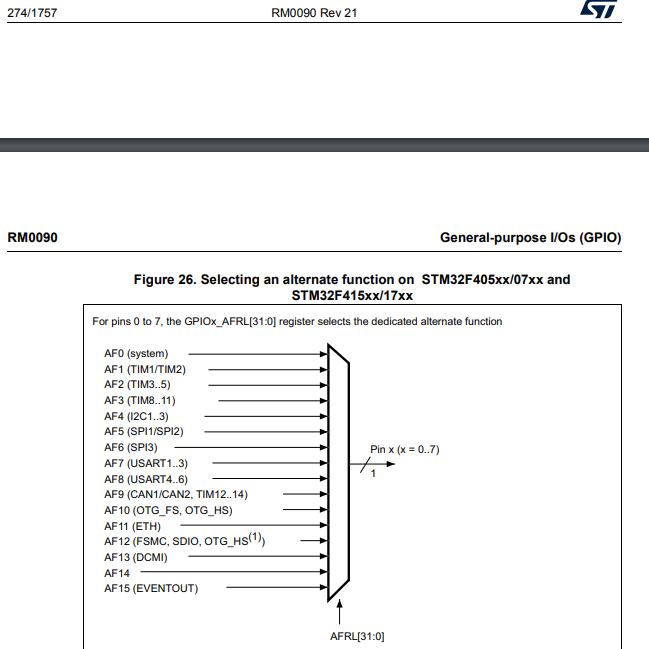

2025-01-10 8:14 AM - edited 2025-01-10 8:21 AM
This is shown diagrammatically in the Reference Manual; eg,
PS:
Highlighting what's defined by hardware vs what's controlled by Software:
2025-01-10 8:19 AM
@Andrew Neil, I will take a look at this reference manual. I've been dedicating a lot of time to learn this since spring semester. I started with the atmega and now I am trying to learn this architecture. I wish I could read faster; all these manuals are very extensive :face_with_tears_of_joy:.
