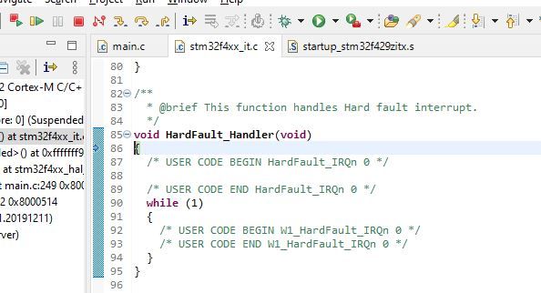

When I use HAL_SPI_Transmit(), it gets stuck at
void HardFault_Handler(void) @stm32f4xx_it.c

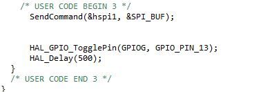

the place I call the function

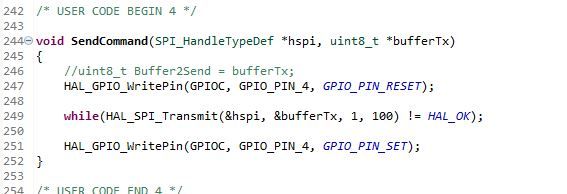

and the function itself (in the main file)

More specifically, when I open debug, press resume this page occurs.

SendCommand(&hspi1, &SPI_BUF);

void SendCommand(SPI_HandleTypeDef *hspi, uint8_t *bufferTx)
//uint8_t Buffer2Send = bufferTx;
HAL_GPIO_WritePin(GPIOC, GPIO_PIN_4, GPIO_PIN_RESET);
while(HAL_SPI_Transmit(&hspi, &bufferTx, 1, 100) != HAL_OK);
HAL_GPIO_WritePin(GPIOC, GPIO_PIN_4, GPIO_PIN_SET);

You are hopeless. Instead of making the recommended change, you go and change things entirely and introduce new errors.
I don't understand how you are compiling these codes as the compiler won't convert uint8_t to uint8_t * without a warning or error. Those warnings should give you a close as to what's wrong.
Similarly, the compiler won't convert uint8_t ** to uint8_t * without a warning or error.
error: cannot convert 'uint8_t** {aka unsigned char**}' to 'uint8_t* {aka unsigned char*}' for argument '2' to 'HAL_StatusTypeDef HAL_SPI_Transmit(SPI_HandleTypeDef*, uint8_t*, uint16_t, uint32_t)'
How are you not seeing these errors?
