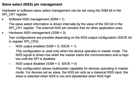

For Hardware mode, refer to ''Slave select (NSS) pin management'' section in the reference manual and check
your configuration according to the alternate function table.
You should check the peripheral is clock enabled and make nss software as an alternative.
Imen
2017-04-12 4:47 AM
Hi Imen,
thanks for your reply. This section only shows the management for the Master. In my case I want to configure my STM32F4 as a SPI slave device with a hardware NSS. Following is my config code for the spi peripheral:
