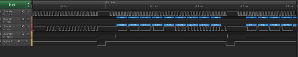

I'm trying to transmit some data using DMA as a slave SPI device. I'm sending 8 byte but the peripheral always gives me 9 byte on the MISO line (first byte twice). The Master NSS is connected to a GPIO input (SPI_ENABLE) using external interrupt Mode with Rising/Falling edge trigger detection. Within the GPIO interrupt routine I set or clear the SPI_CR1_SSI bit as follows.

The attachment shows the result. I have no idea why the first byte is send twice. Does anyone have any idea

I’ve checked briefly the timing diagram attached and have following comments:
· It is not a slave but SPI master which controls number of data transacted on the bus, slave is forced to transmit even invalid data at case no data is ready for transmission at slave side if master continues at transaction (no matter of the slave configuration - slave faces data underrun condition in fact at such a case)
· From the snapshot it seems that master includes 10 data session while slave misses start of the session. SPI enable comes too late at slave at time when master handles the first data frame transaction already (~ at about mid of it).
· Slave must be ALWAYS selected and ready with EACH data frame loaded into data register prior the master starts its transaction on the bus. No matter if hw or sw control is applied for SS, it must be set active before the session starts. The same condition is required for SPI enable which has to be managed while SCK is still at idle to capture well the next transaction start. This is not a case here evidently what make a big mess at data reception at master side (data received are shifted by few bits).
You need either very fast reaction upon interrupt announcing start of the master communication else it is better to keep SPI always ready and enabled to capture correct transaction start and be well synchronized with expected data flow. Note SPI is synchronous interface, slave cannot start its transaction at libitum.
